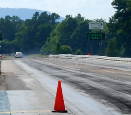

Some comments on my progressive combo, of NX mechanical parts and a NOS progressive controller
Hey young’uns ever hear of rotary solenoids?
And why do you put your jets in the nozzle?
Stainless steel lines, are you kidding?
Within an hour
A small tank, controller box and nylon lines were installed in the backseat,
threaded thru the firewall and hooked up to two strange boxes that went whirr not click
The nozzles [two] seemed all wrong
They had no jets
They just smiled
I mounted the 24.5x8x15 slicks
And pulled to the lights [after warming the tires]
In the next lane was my friend’s gto
[I cut a .002 rx, time, he was at .2]
I wanted a pic of beating a gto
But it was not to be
He was so far behind me
That to get the mph, you don’t get to see him
They told me not, how big a shot
But it was smooth as silk, and the engine did not self-destruct
I instantly bought a turbo
Lol
But when I got to Joe’s for the install
He found I had lengthened the b16 rods
Among other things
I asked caspir if he thought the n20 was involved
His comment
I doubt 187hp and 174 ft lb tq did it
He might have a point
Please understand it would take 450 hp to turn 100mph in the 1/8
That’s like a 250 shot they put through my car
And I got home and to joes
Lol
On rebuild the block and crank were good
The turbo has 700hp rods this time
Hmmm
Look up the English “wizards of nitrous”
And prepare to have your mind opened

the above article is really about the use of extreme amounts of n2o on a built block for drag racing
while still keeping the 180hp torquer for the street
forged 11.5 cr pistons and 700hp 2jr rods would have helped above
and allowed me to keep the plenum for low end
btw
the left out details of the "Race"
mine went 7.5xs
he went low [email protected]
i started two ft behind the line
[he gave me a head start]
his car hopped lol
ran on 17" 325 series r888s
guaranteed rematch with vids
coming in the spring
at atlanta dragway
[he thinks i have an advantage in the 1/8 , atl is 1/4 mile
and i do, i do]
