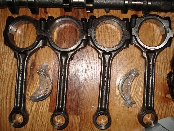

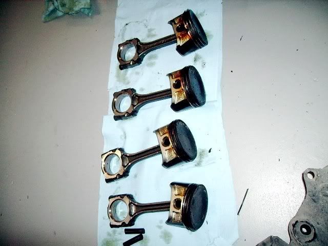

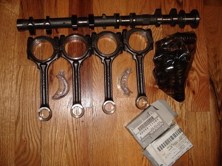

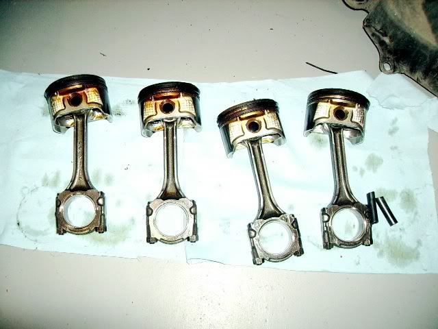

Alright, Just from visually inspecting these pics I would say the rods look pretty similar. So as ppl say the QR on boost is reliable around 270whp as far as rods go, can we "assume" the same for the QG just in terms of visually looking at the rods?
QG18DE STOCK RODS:
QR25DE STOCK RODS:
Im just bringing this up cuz I was just looking at the pics online and noticed a slight difference. What do you guys think?
