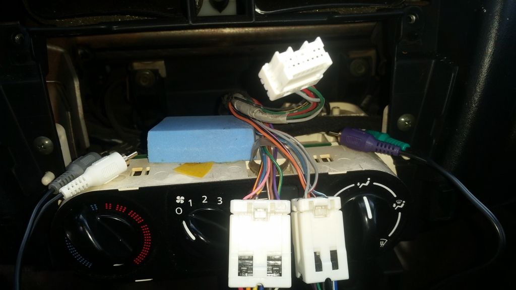

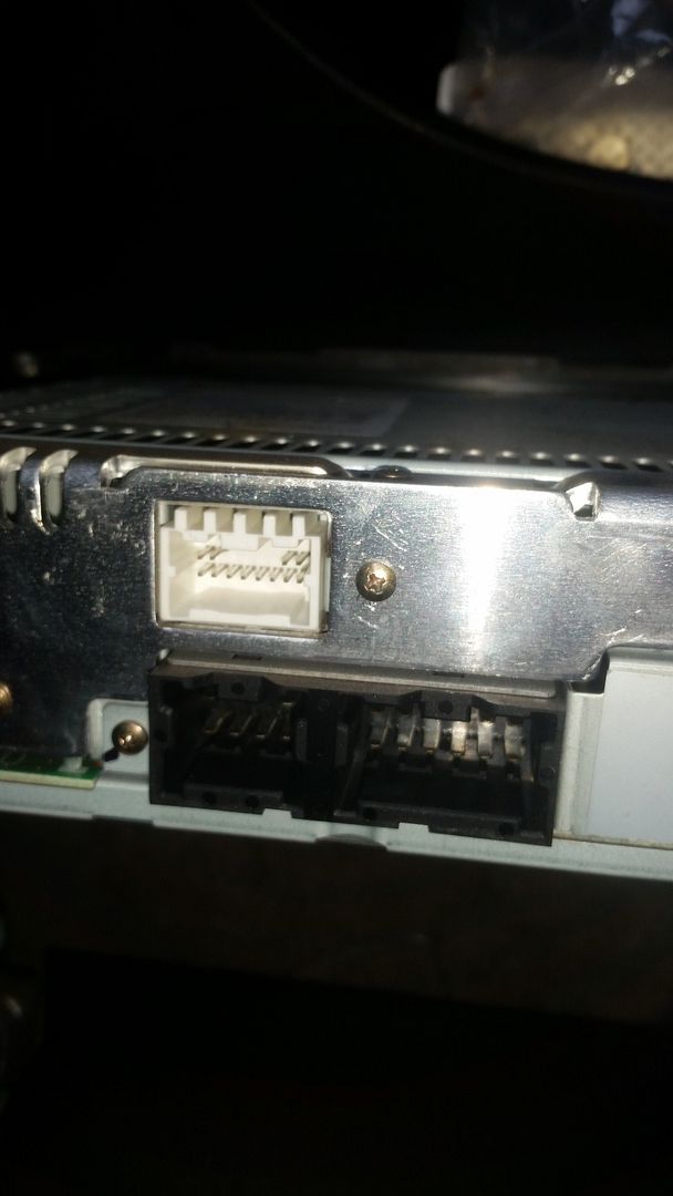

So I got my radio harness adapter and faceplate yesterday. I'm installing today and came across a 3rd harness connected to the top of stock stereo. So my question is what is this harness for? Where does it go for my aftermarket radio? Do I have to have it connected? First pic is my harness adapters connected and the 3rd one at top in question. Bottom pic is back of stock stereo where 3rd connector plugged in.

Looks like the plug for optional CD changer. Can you send a pic of the back of that plug also look under the heater controls and see if the other end is there with same style plug.

that third one is for the CD changer.

That third harness is a patch harness for an aftermarket unit.

Lol Im pretty sure that harness is for XM radio that was added into the harness
