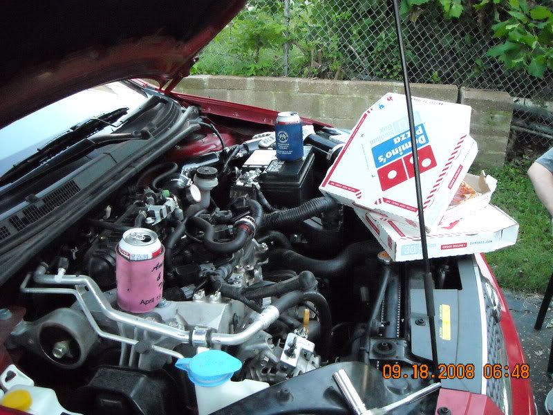

before

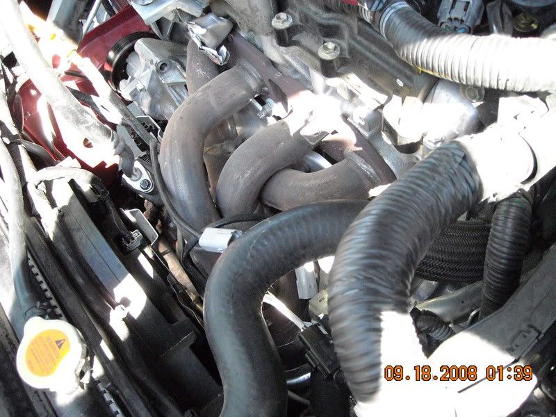

what it looks like without the shield

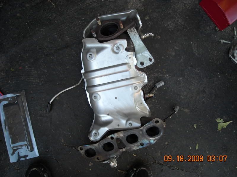

what it looks like with no manifold
ugly fucking waste of engineering dollars

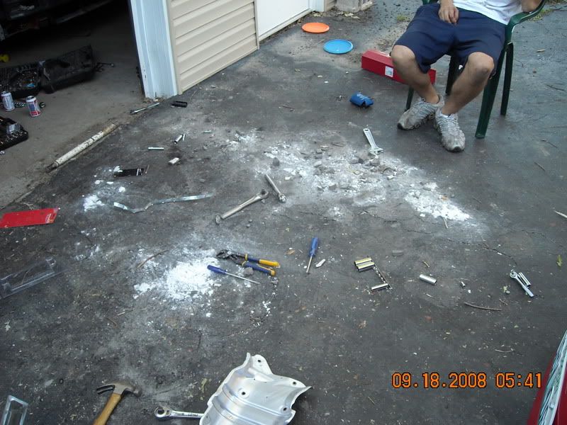

this is the amount of shit that came out after cleverly utilizing a bunch of random tools to knock the kitties out

big ass mess in my driveway

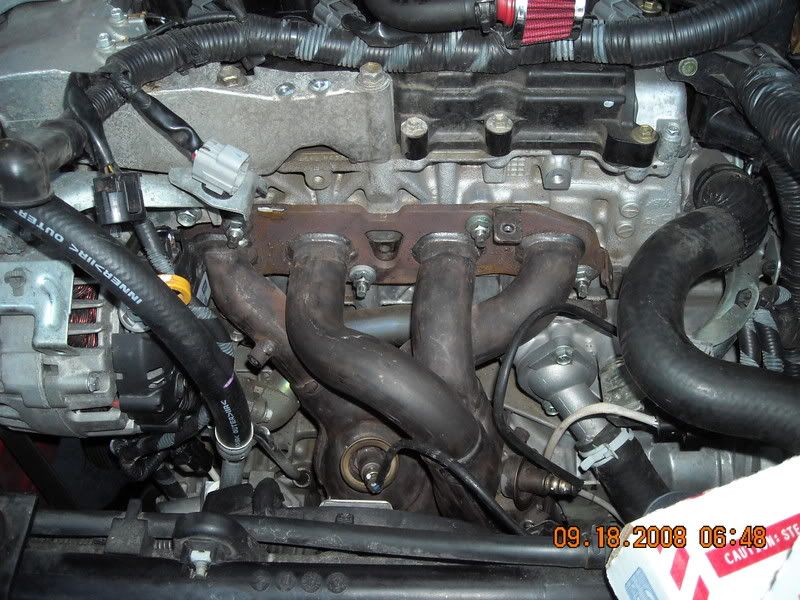

done its back on. refuel.
