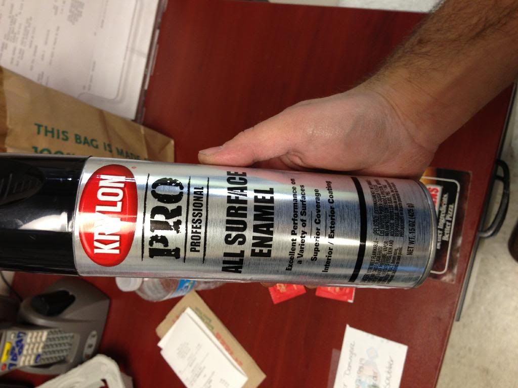

I work at Sherwin Williams and we carry this product, All Surface Enamel gloss black. So I bought a couple cans and went to town.

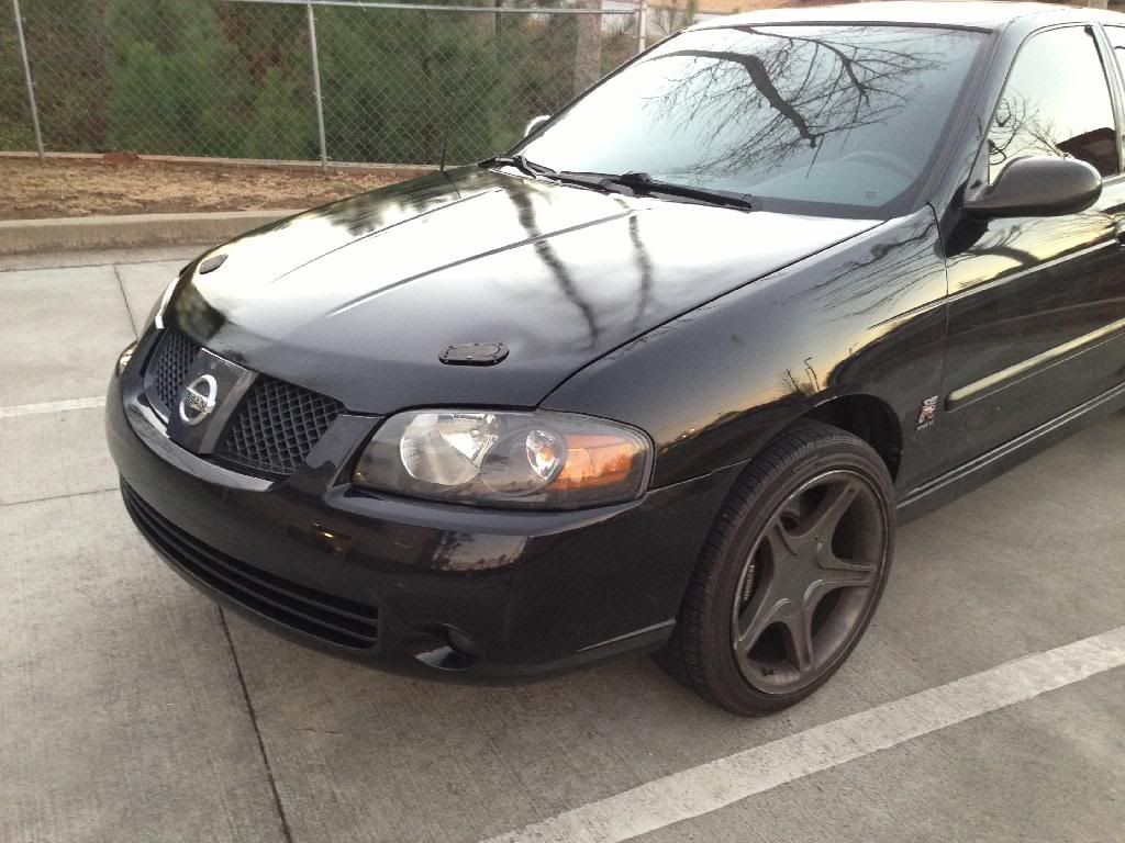

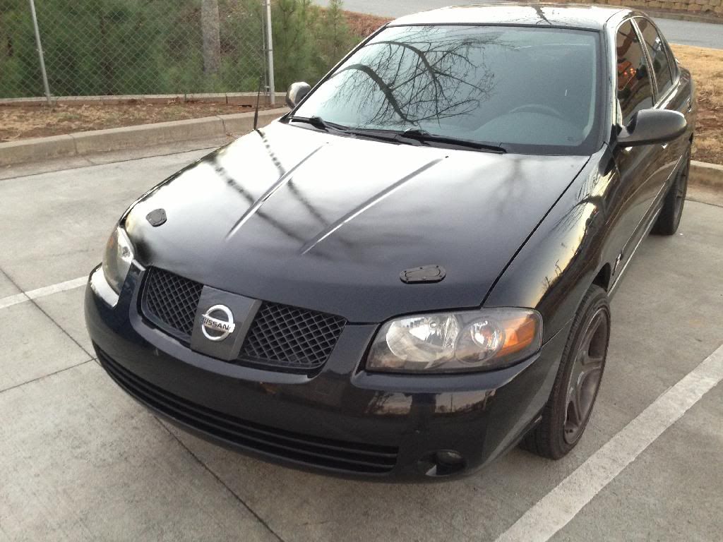

Before:

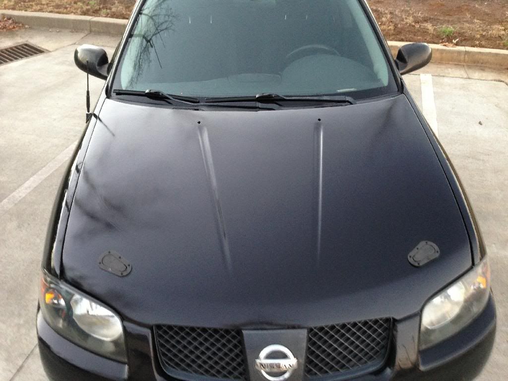

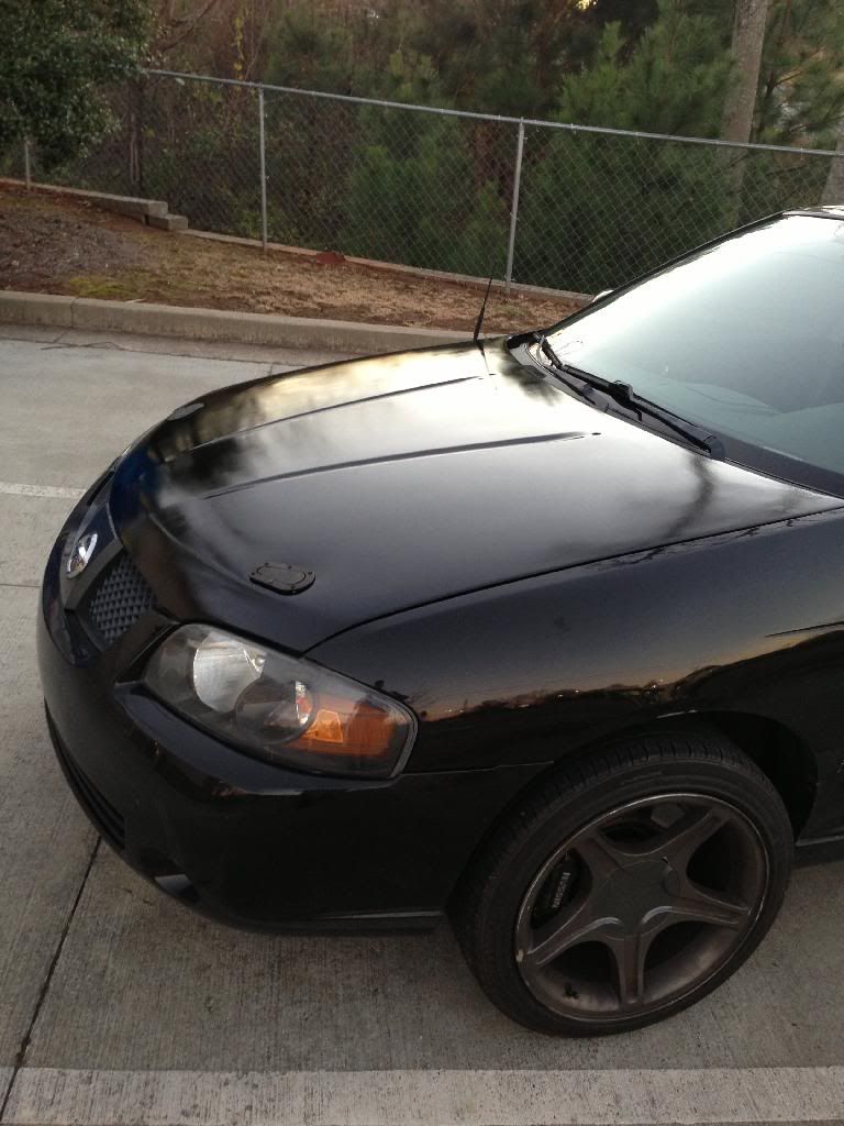

After:

Damn that looks pretty clean for just being rattle canned. Good job!
2,675 Posts
Wow what a difference!

If this was cut and polished it would look like a pro job. Try a coat of clear, then wet sand 2000-2500 grit, cutting compound (Meguairs Ultimate Compound), then polish
One could honestly not tell the difference with the bumper (pro shop paint job), to my rattle can job with the Nismo lip
