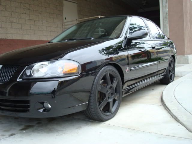

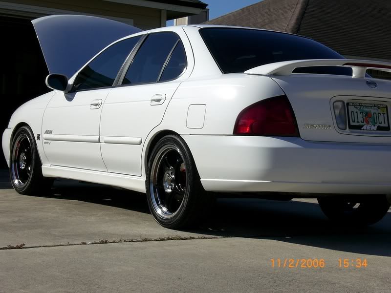

Ahhhh ... in real life sportlines look waaaaaaay lower, and the Megan pic that guy HAS to be running wheels off a Honda, those gotta be 205/40

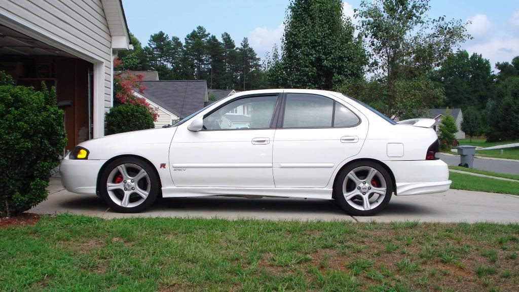

One of these can be added to the list. Mine are the first pics I've seen of Swift springs. This is on stock wheels and tires. Feel free to delete this post afterwards.
