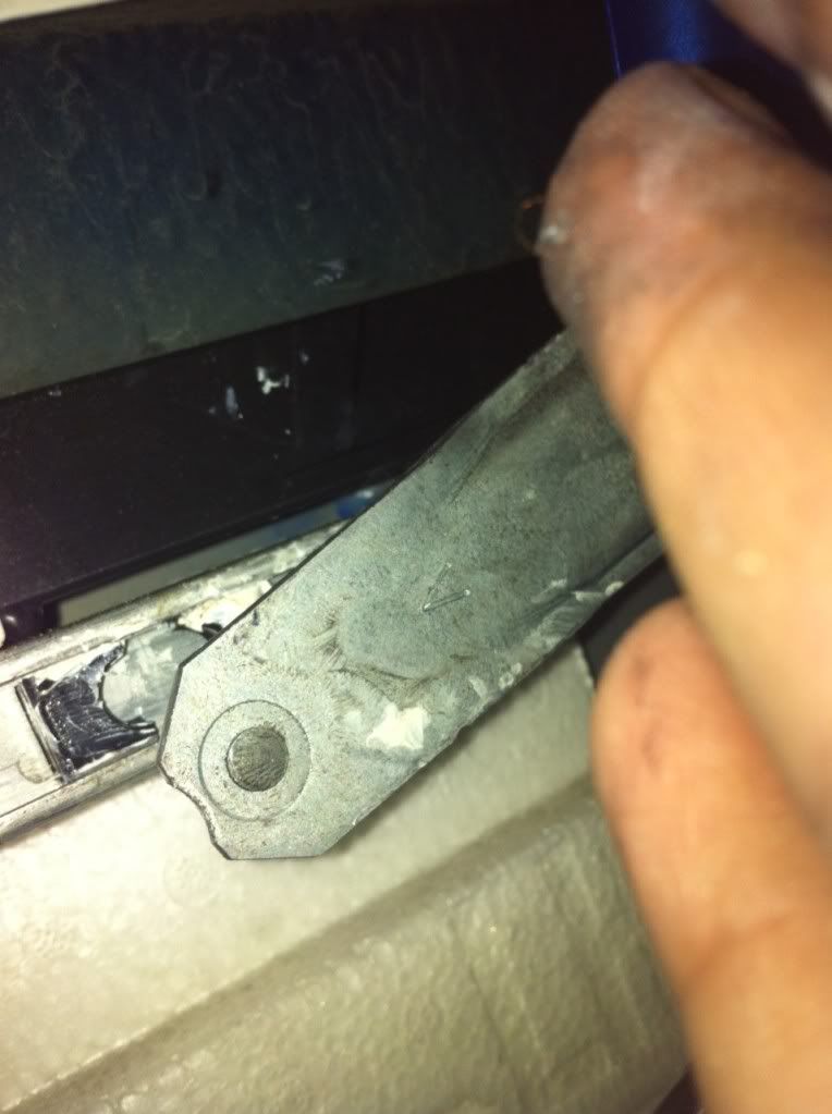

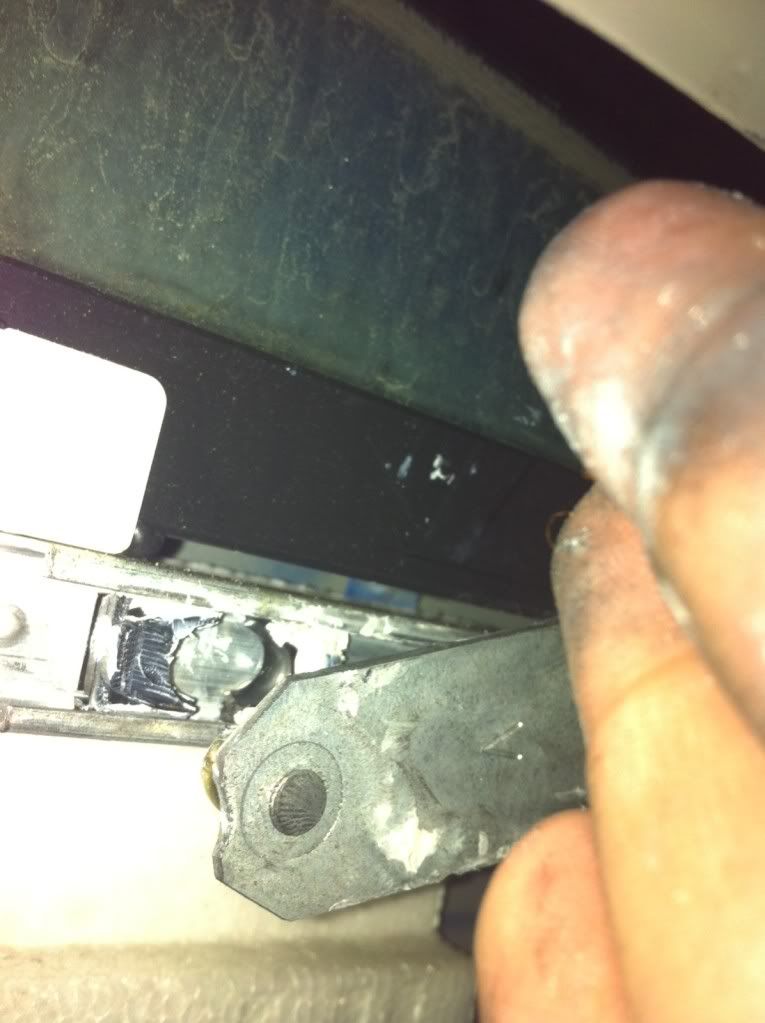

Yesterday I went to roll up the left passenger window and it just fell into the door. Opened up the door panel and the motor arm works but I'm not 100% on how the side black pieces were to stay snug around the knob of the arm. I have some pics below. I looked to see if any parts broke off and fell but I didn't feel anything. Any help ?
#3 ·
Seems like that's how it would work. The pin would go through the two black sliders and the knob connected to the lever. I would need to check if there's actually a hole to run through all three of the pieces. Anyone know ?

I don't believe there's a cotter pin holding the ball into the plastic slider. I can't see the pictures as my work network blocks that kind of thing, but it sounds like exactly what's happened to each of my rear windows. The plastic slider breaks in half and the window simply falls into the door.

I pushed the two black sliders closed in onto the ball but it doesnt stay. I pushed it in just enough for it to stay on the track and powered them up. But if i try to put the window down it just drops because the ball doesnt stay on. im so confused.

ah yes this happen to me on the rear driver passenger door. all you have to do is take out that whole metal piece where the plastic slides. Take those out because that piece broke those two where supposed to be connected together. in order to take the piece out unscrew the the bolts that hold that metal slide. use vice grips to open one side so the plastic pieces fall out. use vice grips to close it back up. now the ball can fit in there and if not open one side so th ball can fit. pretty much vice grip the whole bar to where the ball moves back and forth with out it coming out. and your set ill see if i can get some pictures. today?
