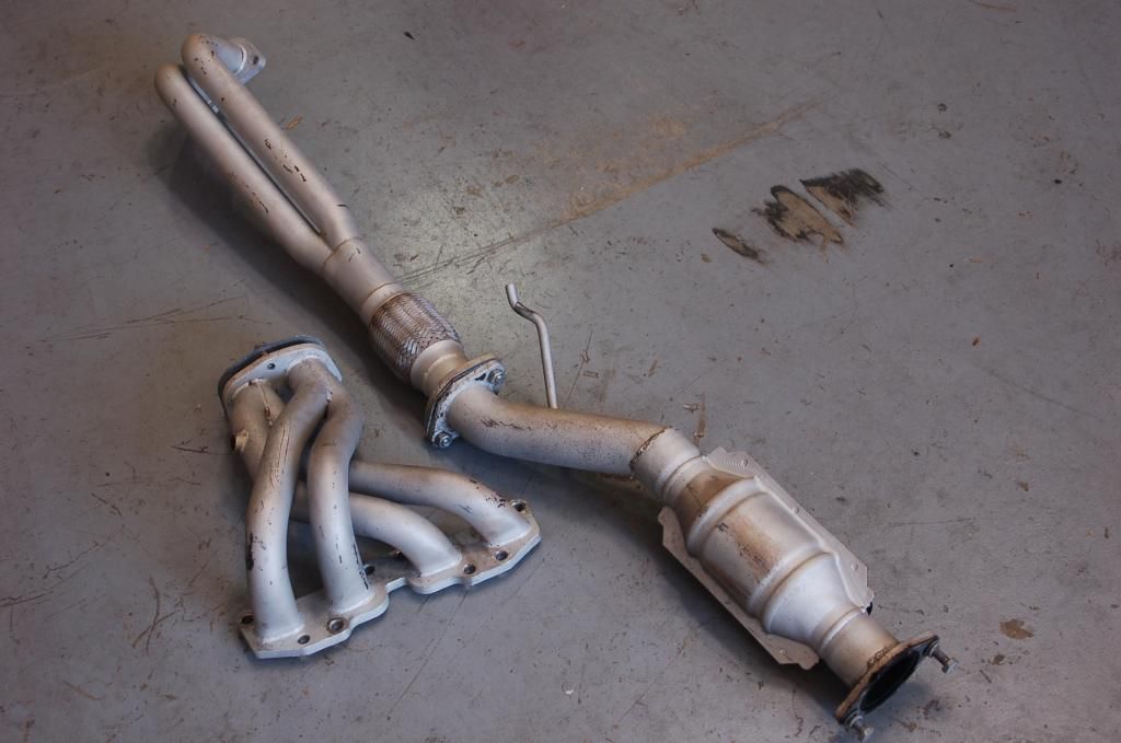

Make sure you buy a better header too.
For sure. I was just going to run the eBay header until the 2J header came out but if there's a better piece to go to in the mean time or just period I might make the switch if it's not too costly.
I looked through the header thread but there's so many different opinions and little dyno info that I wasn't sure what was best.

I do need to get rid of the eBay header though. If I'm putting this much money into it already I might as well just get the race header.
